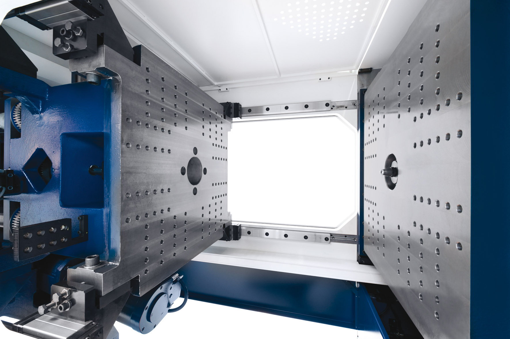

Zhafir Mercury features a tiebarless clamping unit.

On display at NPE2012 April 1-5 (booth 1573) will be a  Zhafir Mercury 1000-35/35,  a tiebarless, all-electric machine that uses side  plates rather than tiebars to create 70% more mold space, allowing use of larger tools on smaller machines.  The machine design is described as 30% slimmer than previous models, boosting productivity per square foot.
The toggle clamp mechanism has just two levers and a central servo direct drive. The simplified design is aimed at smoother machine operation in an effort to boost repeatability. There is no lubrication requirement. The Zhafir Mercury series became available for sale in the United States this month for the first time.
