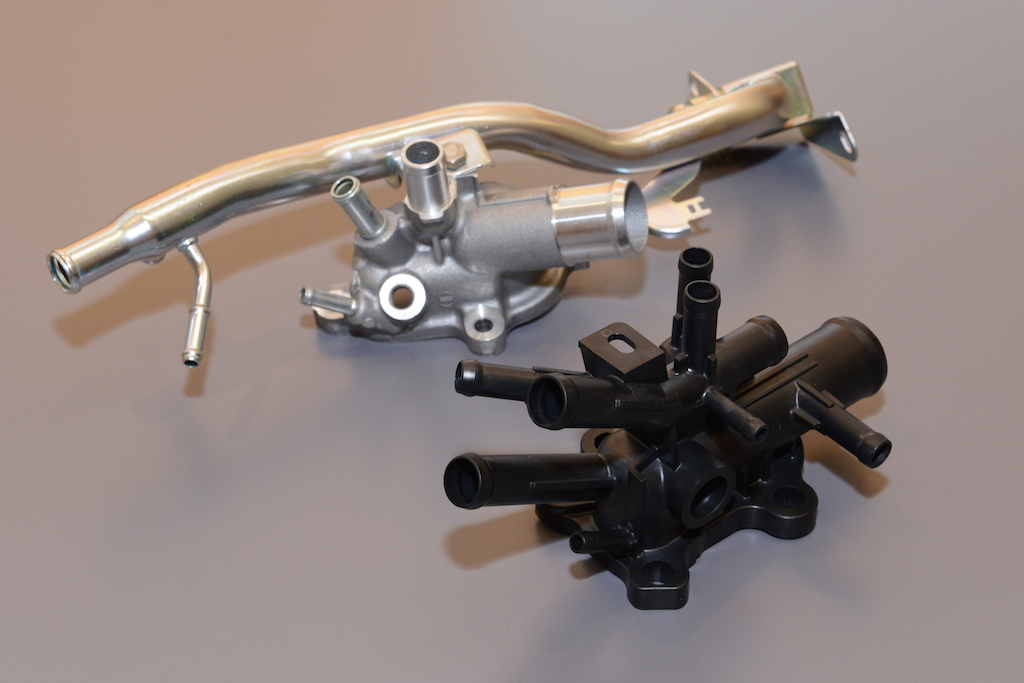

The 10-port water outlet injection molded out of engineered thermoplastic demonstrates metal-to-plastic conversion. Credit: Industrial Molds Group. |
In many cases, multiple metal parts that make up a larger component need to be welded in a secondary operation which adds to the time and the cost. Also, where there is a welded area, there can be a tendency toward a weakness in the metal. By combining several metal parts into one molded plastic part, the resulting product or component is stronger and performs better. Additionally, plastic components are relatively maintenance free as they do not need coating or painting to protect the material.
