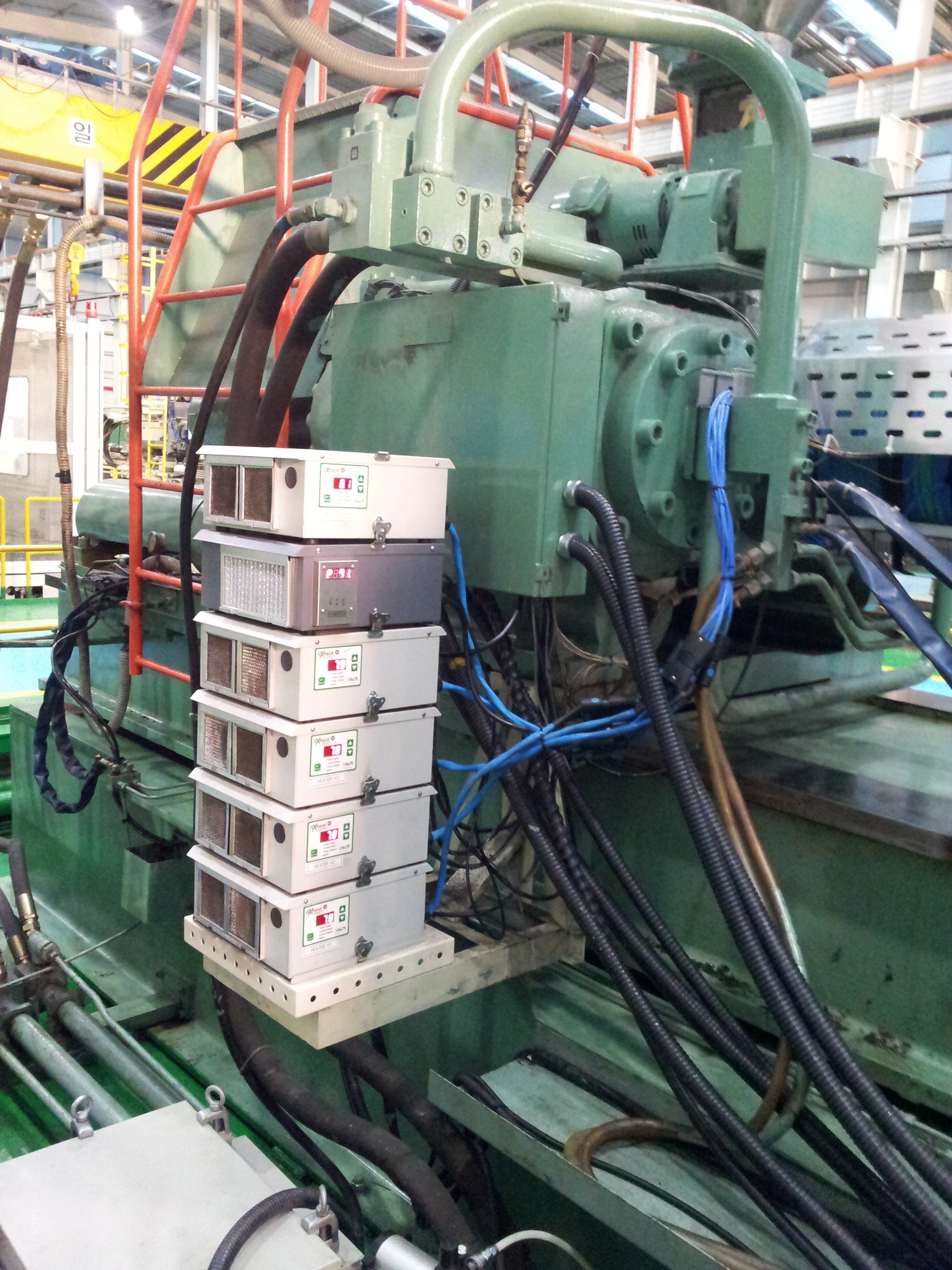

The Eco-heaters employs insulated Litz cables wrapped around a foam-insulated barrel to heat the injection cylinder, and in doing so reduce power consumption by up to 60% according to its supplier. "We've taken the Xaloy technology and made improvements so that it works better in an industrial environment," says ECOnomical Heater overseas sales director K.J. Choi. "And because it's developed in Korea, if a local customer wants to invest in this technology they can obtain a seven-year loan from the Korean government at a 2.75% annual interest rate."
Hyundai Mobis is one Korean molder using the system, employing 6 x 8 kW modules on a 3000-tonne JSW press for molding bumpers. The processor has been able to reduced barrel preheating time from 112 using ceramic heaters to 91 minutes, as well as energy consumption during production from 24 kW/hr. to 12 kW/hr. This equated to savings of over $21,000 annually. "Generally, users can enjoy a payback period of one year," says Choi.
