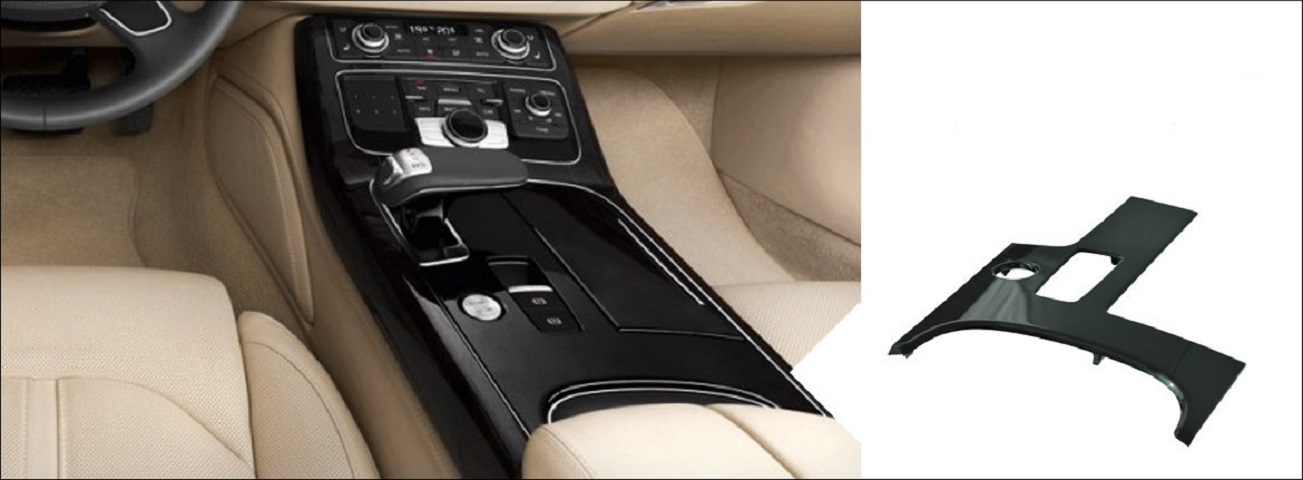

This console trim part is being molded at Engel's booth (W1303) using RocTool technology.
