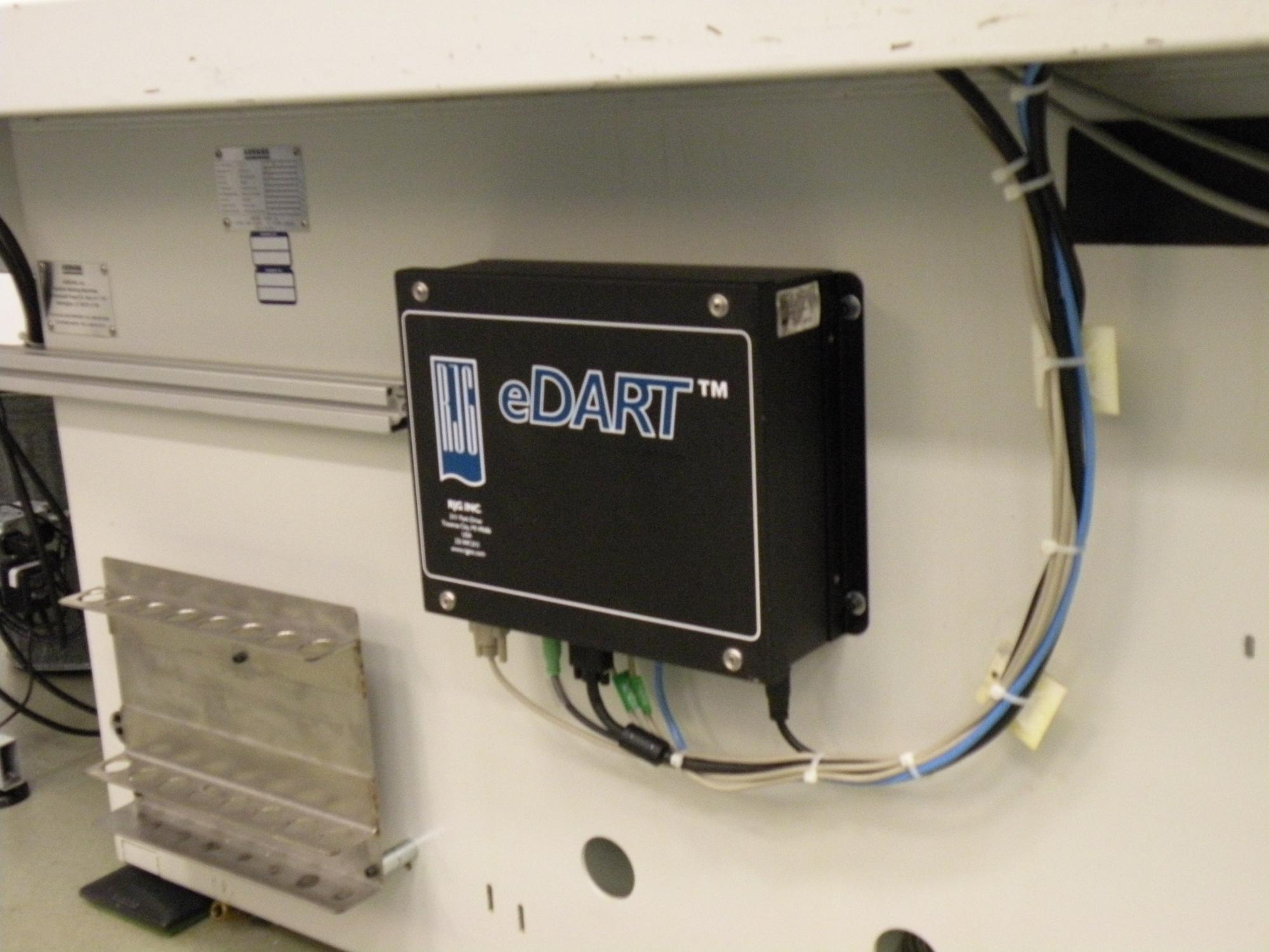

When Gattshall first started at The Tech Group's Grand Rapids injection molding and assembly facility, the plant had four of RJG's eDART process monitoring and control systems, although none were mounted to a machine. Instead, the monitors sat in blue cages and were used sparingly and mostly in process qualification. The Tech Group had embarked on an initiative with all their manufacturing plants to fully engage process monitoring. Standardizing on E-Darts was just on of the tools used to assist in the process. The Tech Group also had a dedicated Master Molder III on staff with over 20 years experience and black belt certified to support the global initiative.  Tech Group Michigan needed to embrace this initiative and Gattshall was given the task.
Starting with one press, Gattshall put the eDARTs into service, adding a touchscreen control as well as thermocouples in the oil heaters for the mold, allowing the system to monitor mold temperature in each half. By doing this, they could prevent set-up errors. Next, cavity pressure transducers were deployed, and using their tags, they were able to tell the eDART which mold was in which press, preventing any errors in mold installation.
In time, Tech Group would purchase another 35 eDARTs, mounting them all to injection molding machines. "It was a huge capital investment," Gattshall says. "Once we proved that it would work, we went all in."

InTouch stresses the possibility of customizing its system, which it bills as offering real-time production monitoring, reporting, and planning, and the Tech Group fully exploited the ability to tailor the software to its needs. Now, when technicians hit "start job" on the InTouch user interface, the system automatically populates all the information from the RJG eDART, including job number, material number, and all the other data points that technicians would enter. Gattshall says one of the next steps for The Tech Group will be the elimination of process monitor logs.

Utilizing the functionality of RJG's eDART, The Tech Group will further boost productivity and remove the opportunity for human error. Gattshall says eDART's inject enable and good part signal, working off process specifications supplied by the customer, will allow The Tech Group to deliver good parts to customers with confidence.
Every process has many variables that determine if the end result is acceptable or not. "The EDart system allows us to monitor key molding variables in every shot, as they occur. Once we've established key statistical process control limits, based on acceptable cosmetic and dimensional part requirements, we use the limits to determine acceptability of each molding cycle. If any of the key process variables violate the control limits, the shot is automatically diverted. Think of a football player kicking field goals. Would you want your kicker to always be wide left, wide right, or down the middle?  Utilizing the EDart gives us shot to shot visibility to ensure all parts we delivery to our customers are made right down the middle of the process," states Gattshall.
