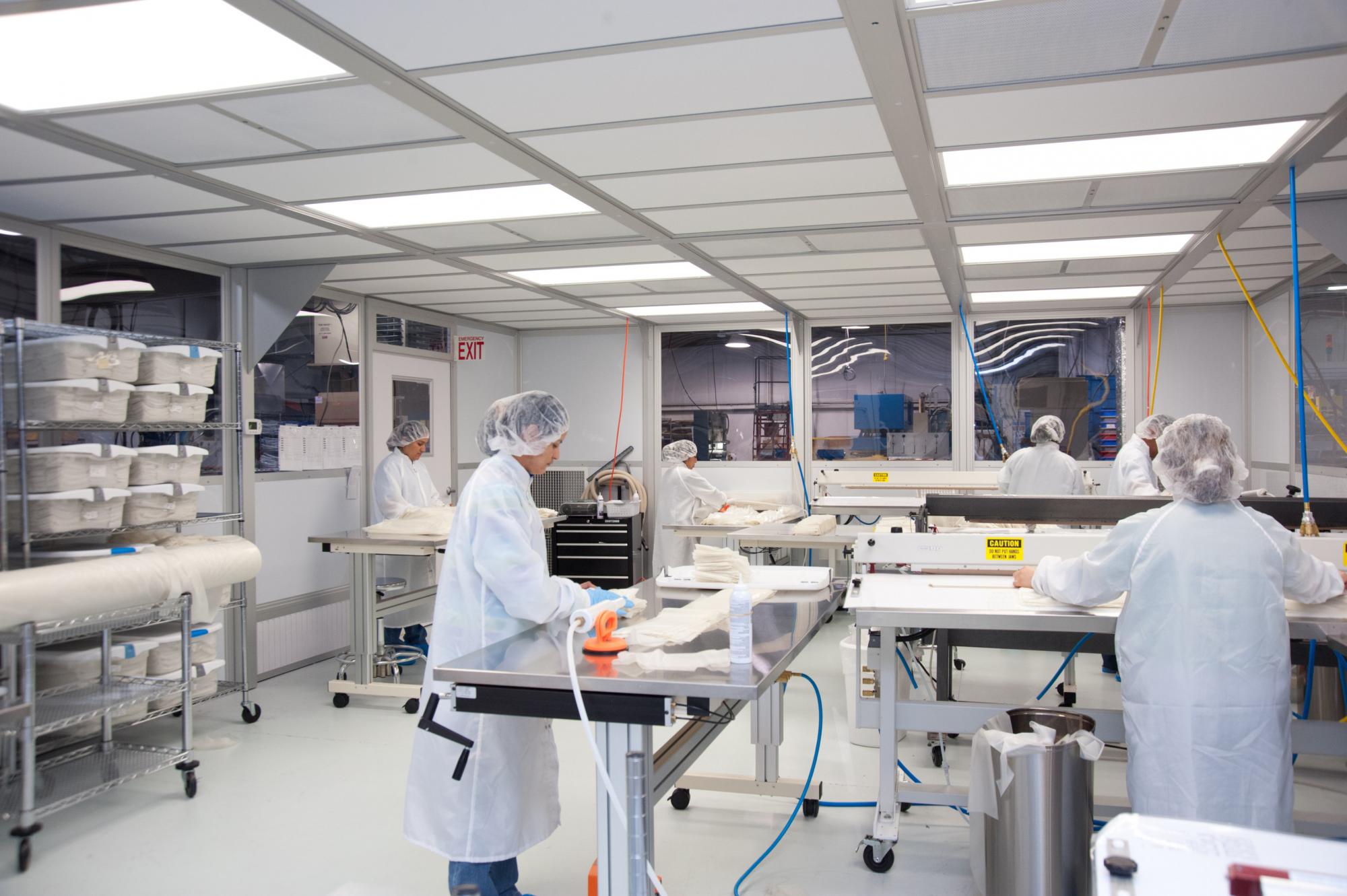

Genesis Plastics Welding (Fortville, IN) showed the latest versions of its ecoGenesis radio frequency (RF) welding technology at NPE2012 (Orlando, FL; April 1-5), but the underlying technology is not new; it was
The shift oiut of PVC IV bags and tubing is saving major healthcare groups millions of dollars.

Genesis Plastics Welding was formed in 2008 when it acquired the ecoGenesis technology and launched a major expansion. Predecessor companies were called Plastics Welding Technologies and Genesis Manufacturing. The most recent expansion includes a doubling in the size of its Class 7 medical clean room.
