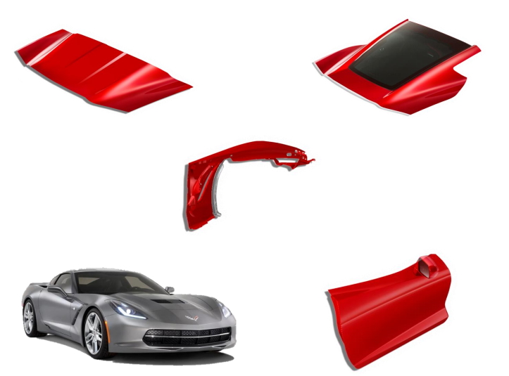

Potential applications for the ultra-lightweight SMC include roof bows, hatches, doors, deck lids, fenders and tonneau covers.
Specifically, Ultra Lite technology uses treated glass bubbles to replace some of the CaCO3, allowing the resin to adhere to the matrix and increase the interfacial strength between the bubble and the resin. This is a patented treatment technology that results in a more robust resin mix that makes molded parts more resistant to handling damage, and prevents the micro-cracks that cause paint pops, pits and blistering. The treated bubbles also help with paint adhesion and bonding characteristics.  When combined with CSP's patented vacuum and bonding manufacturing processes, the result is a material with a premium Class A finish with paint and gloss qualities comparable to metals, including aluminum.
Depending on the body component being developed, design studies have shown that CSP Ultra Lite offers a weight savings of up to 21 percent over the company's mid-density TCA Lite(1.6 SPg), and 35 percent over its industry-proven standard TCA material (1.9 SPg).
