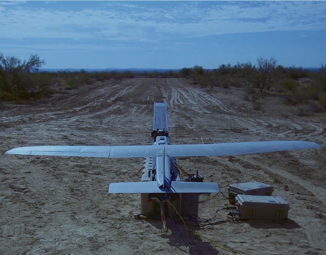

The Silver Fox UAV weighs 36 lb, boasts a mission endurance of greater than eight hours, a payload of 5 lb, and is launched by a gas spring catapult.
Ultem XP060 foam is employed in external payload fairings for the Silver Fox UAV.

Due to the minimal remaining volume internal to the Silver Fox UAV, the military customer elected to mount an oversized payload module and an inertial sensor on the exterior fuselage of the aircraft. This presented a challenge considering that the payload shapes were non-aerodynamic and created significant drag, having a negative impact on the aircraft's range and endurance.
BAE Systems requested UDRI to create aftermarket fairing assemblies for the external payloads to solve these challenges. By using Sabic's Ultem XP060 foam—which added a mere 3 oz of weight to the UAV-UDRI—BAE Systems were able to reduce 92% of the profile drag of the un-faired payload and sensor module, and aircraft endurance was restored.
