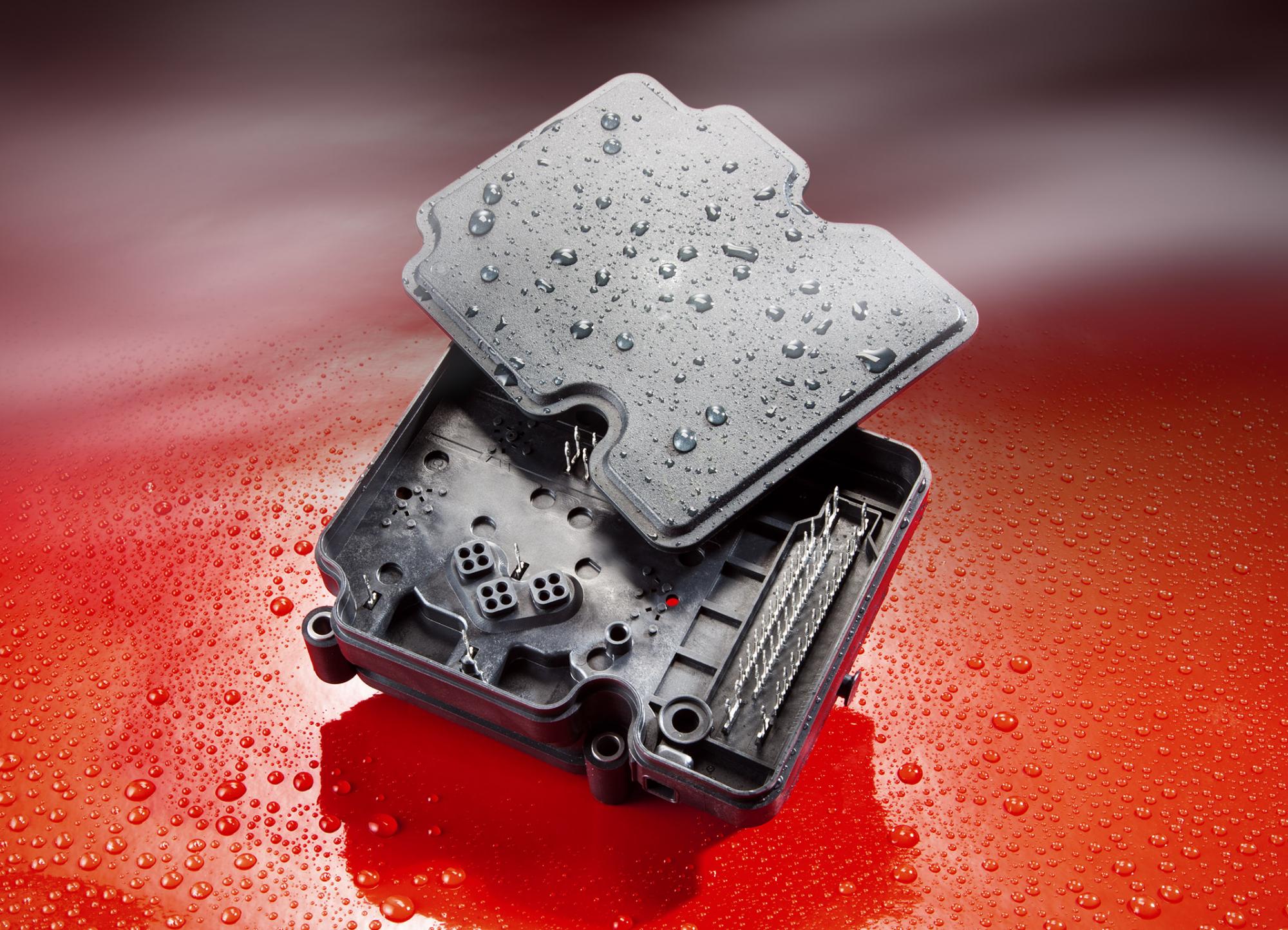

PBT offers hydrolysis resistance for demanding auto applications. |
