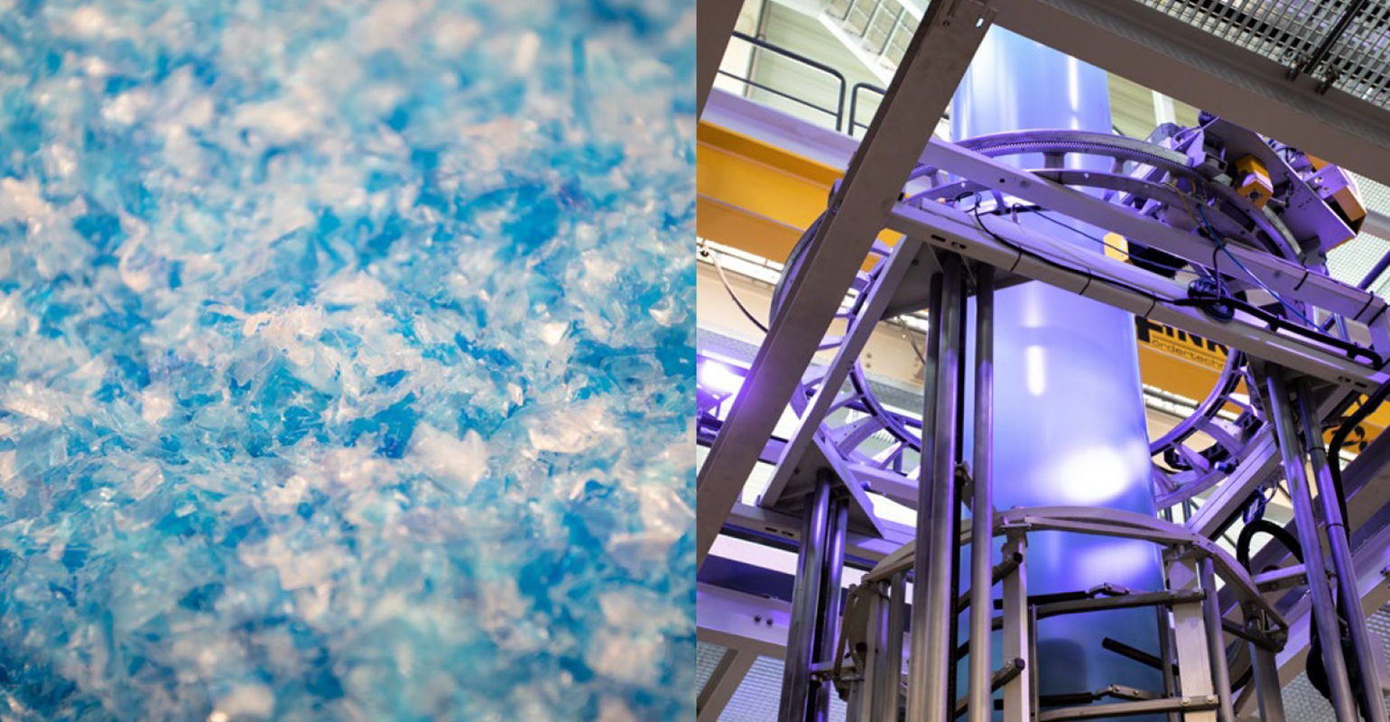

Lowest-quality recyclate processing with EVO Ultra Fusion.
High recyclate content in packaging is just as important as recycling-friendly design of plastic products. However, manufacturers face new technical challenges in processing recyclates, with one of the biggest problems being the widely fluctuating quality of the input material.
Reifenhäuser EVO Ultra Fusion extrusion process permit blown-film producers to be less dependent on the input quality while dispensing with the energy- and cost-intensive regranulation of the recycling material. Fluff aka film shreds and all types of production waste and PCR material can thus also be extruded directly.
Ultra Fusion processes even the lowest quality recyclates, which were previously inappropriate for the blown film process, into functional films for applications such as trash or mailing bags. This is made possible by twin-screw technology that ensures a stable process for a better melt homogenization,. Processors can also degas the system very easily and effectively, removing unwanted ingredients in the recyclate.
