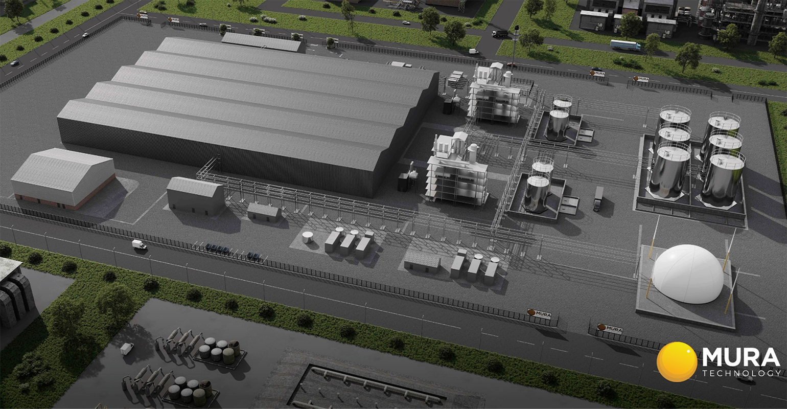

Mura Technology recycling facility
Mura Technology's UK recycling facility. Through the partnership with Dow, it aims to build multiple facilities across the United States and Europe.Image courtesy of Mura Technology

  • A collaboration with UK advanced recycling company Mura Technology to build multiple facilities across the United States and Europe and add up to 600 kilotons of advanced recycling capacity by 2030. Dow will be the primary consumer of the circular feed to come from each of the 120-kiloton facilities.
The project marks a significant scaleup of Mura’s HydroPRS (Hydrothermal Plastic Recycling Solution) advanced recycling process for all types of plastics, including flexible and multilayer materials deemed unrecyclable. The first plant to use the technology, in Teesside, UK, will feature a 20-kiloton-per-year production line and is set to begin operations next year.
