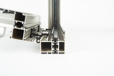

Window profiles for buildings is one application targeted by eco TPV grades.
