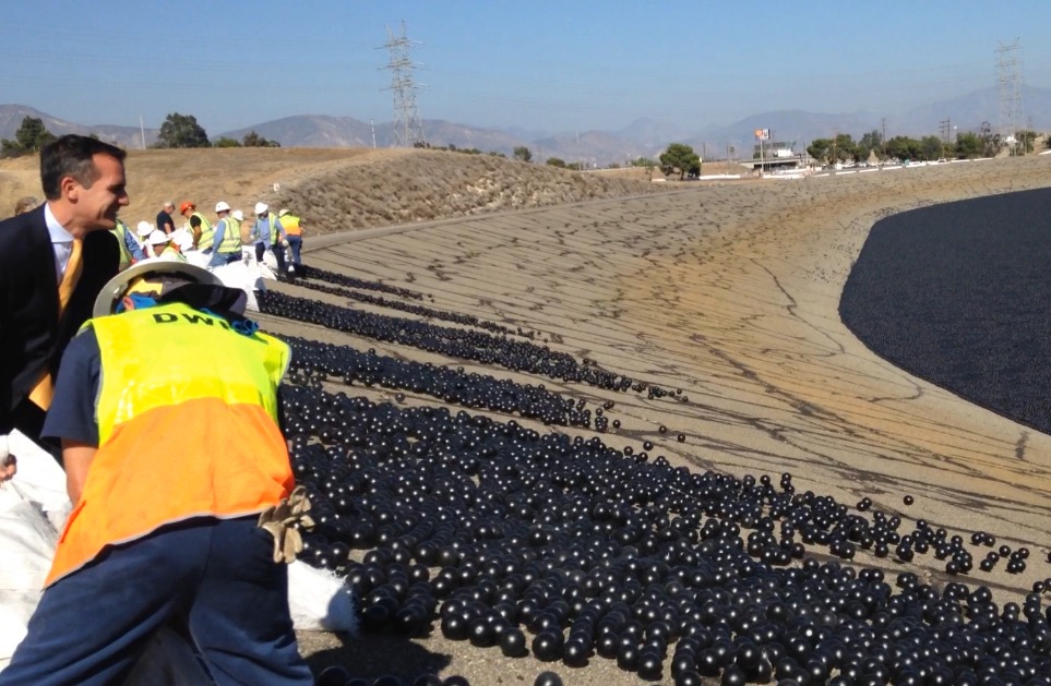

Last week, Los Angeles released the last 20,000 “shade balls” into the Los Angeles Reservoir, marking completion of a $34.5 million initiative to protect water quality and to save 300 million gallons of water a year from evaporation. The Los Angeles Department of Water and Power (LADWP)is the first utility company to use this technology for water quality protect—the largest in-basin facility of its kind owned and managed by LADWP.

The small, black plastic balls protect water quality by deterring birds and other wildlife, and protecting water from rain and wind-blown dust. They also help to prevent troubling sunlight-triggered chemical reactions: the reservoirs contain bromide, which occurs naturally in groundwater, as well as chlorine, which was being added to disinfect drinking water. When bromide and chlorine react with sunlight, they form bromate, a suspected human carcinogen.
Dr. Brian White, a now-retired LADWP biologist, was the first person to think of using shade balls for water quality. The idea came to him when he learned about the application of “bird balls†in ponds along airfield runways. The innovative, in-house solution has been used in LADWP’s open-air reservoirs since 2008 to block sunlight, prevent chemical reactions and curtail algae blooms. Currently in place at Upper Stone, Elysian and Ivanhoe reservoirs, the shade balls come with the added benefit of reducing evaporation off the reservoir surfaces by 85-90%.
