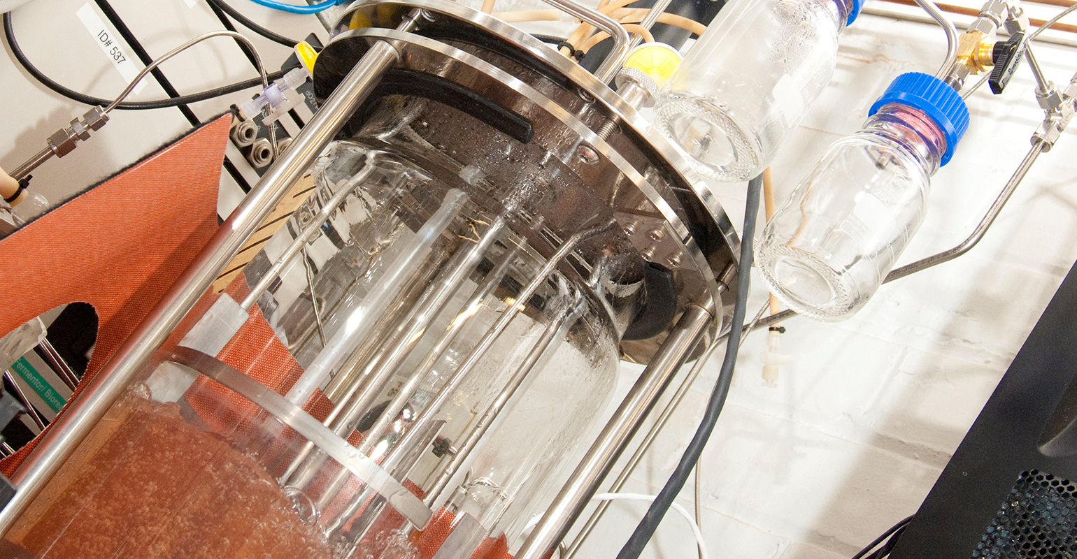

A consortium that includes LanzaTech and Danone discovered a new route to monoethylene glycol, (MEG), which is a key building block for polyethylene terephthalate (PET), resin, fibers, and bottles. The technology converts carbon emissions from steel mills or gasified waste biomass directly into MEG. The carbon-capture technology uses a proprietary engineered bacterium to convert carbon emissions directly into MEG through fermentation, bypassing the need for an ethanol intermediate, and simplifying the MEG supply chain. The direct production of MEG was proven at laboratory scale and the presence of MEG was confirmed by two external laboratories.
“We’ve made a breakthrough in the production of sustainable PET that has vast potential to reduce the overall environmental impact of the process,” says Jennifer Holmgren, CEO of LanzaTech.  “This is a technological breakthrough which could have significant impact, with applications in multiple sectors, including packaging and textiles!”
While there is no organism in nature known to produce MEG, LanzaTech has used Synthetic Biology and artificial intelligence (AI) tools to discover multiple novel pathways to make MEG directly from carbon emissions. By combining and prototyping various sets of enzymes identified from different sources in novel ways, LanzaTech has successfully reprogrammed its ethanol producing bacteria to fix and channel carbon into MEG.
This early-stage proof of concept work shows for the first time that it is possible for a bacterium to directly produce MEG from gas.  By producing MEG directly, the new technology avoids the multiple processing steps required to convert ethanol into ethylene, then ethylene oxide and then to MEG. LanzaTech anticipates that when scaled successfully after a multiyear development phase, the direct production process will lead to PET bottles and PET fibers with a reduced environmental impact.
