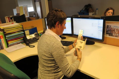

Mathilde Richy, Structural Calculation Manager, Sodimas, testing her 3D printed fastener produced on a Stratasys Fortus 450mc 3D Printer (Photo: SODIMAS)
“With Stratasys’ FDM-based 3D printing solutions, our CAD engineers can send designs directly to the Fortus Production 3D Printer and have the printed parts in their hands in just a few hours for testing,” says Stéphane Réau, deputy technical director at Sodimas. “To put that efficiency into context, using traditional means [of machining aluminum], we would previously have been looking at around a 15-day lead time before having the part ready to validate for design and fit – so we’ve basically slashed this from two weeks to two or three hours.”
