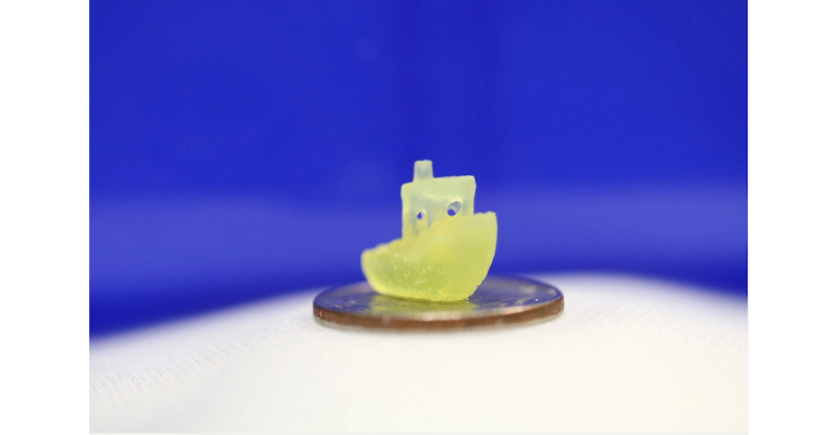

Researchers working at Rowland Institute at Harvard University developed a new 3D printing process that eliminates the need for support structures to enable “true” 3D printing, they said. The process uses blue light from the laser in the process to create objects. Pictured is a boat that was fabricated using the process.Image courtesy of Daniel Congreve

To prove that their process works, researchers scanned a number of objects, including a 3D Harvard logo, a Stanford logo, and a small boat. The last is a standard yet difficult test for 3D printers because of the boat’s small size and fine, overhanging details—such as portholes and open cabin spaces—that previously would have required support structures.
