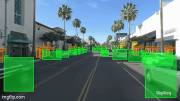

Nick Westra: Since the invention of the modern vehicle, technology has always aimed to deliver a safer and more comfortable driving experience. With the growth and widespread use of advanced driver assistance systems (ADAS) in modern automobiles, drivers can reduce the areas that need constant attention and avoid collisions. Advancements in tire pressure monitoring, blind spot detection, lane monitoring and adaptive cruise control all provide a level of automation that allows drivers to remain focused on staying on the road. Sensors such as LiDAR and radar allow onboard computers to map out the vehicle's surroundings and, when integrated into the whole ADAS system, allow for increased protection and a smoother driving experience.

Nick Westra: One of the most interesting applications of AI in the automotive field is autonomous driving. SAE International (formerly the Society of Automotive Engineers) states that vehicles are considered self-driving at SAE Level 3 and above, which means the vehicle makes most of the driving decisions, even if someone is sitting in the driver’s seat. Currently, only a few vehicles reach this level of automation, and then only in certain conditions or locations. The place for in-vehicle AI is to close that last bit of the automation gap to enable it to work in all operating conditions and locations. Aside from the obvious computing power needed, the need for sensors around the car to take in and process environmental data will be of the utmost importance. Technologies like LiDAR, radar, ultrasonics, and computer-based machine vision will all be needed to ensure the vehicle can sense what is happening around it at all times.
