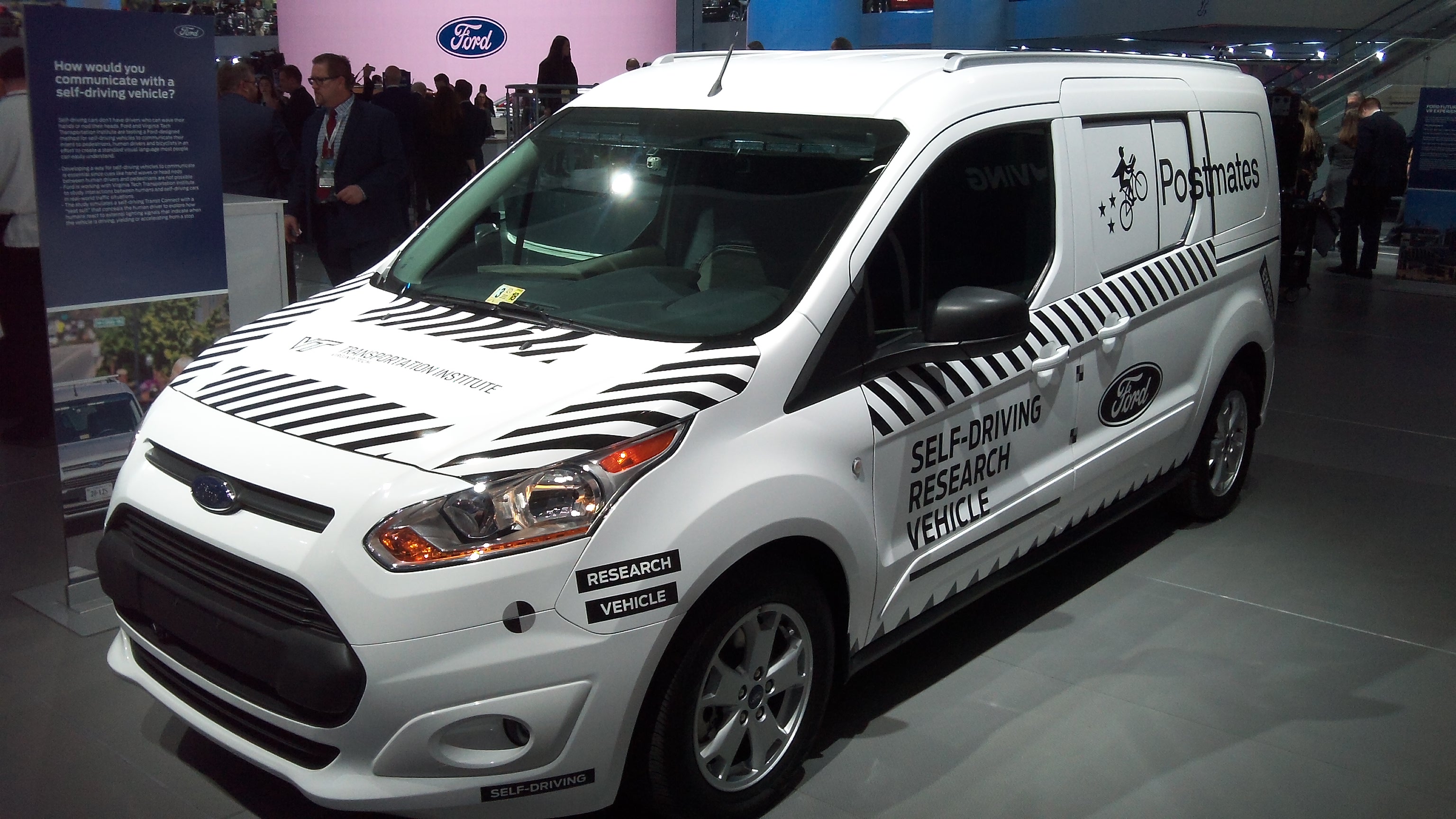

At the North American International Auto Show, Ford Motor Co. showed off an autonomous van with a light bar that communicates with pedestrians. The idea, Ford engineers said, is for the pedestrians to know what the car is thinking. (Source: Design News)

To address such issues, automakers have begun working on the softer side of the problem, as well. At the Detroit auto show, for example, Ford Motor Co. showed off an autonomous van with a light bar that communicates with pedestrians. The idea, Ford engineers said, is for the pedestrians to know what the car is thinking.
“Suppose I’m a pedestrian, and this autonomous car comes up to deliver a pizza,” noted Wayne Williams, research engineer for Ford autonomous vehicles. “I’d really like to know, as a pedestrian, whether this car knows I’m there and whether it’s going to start rolling if I walk in front of it.”
Ford says that it’s working with SAE and with the International Organization for Standardization to push for a standard way of enabling cars to communicate their “thoughts” to the world around them.
