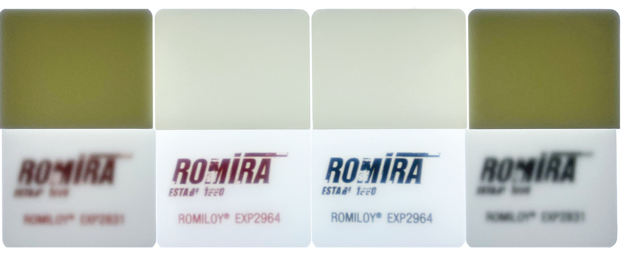

A clear difference in quality between a standard grade and the new grade is apparent in this graphic. Sample plates produced with standard material are shown on the left and right. Shown between these is a sample of the newly developed Romiloy showing clean, translucent lettering in red and black. Image courtesy Romira.
