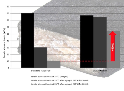

New laser-weldable grade features greatly-enhanced tensile strength at break after extensive heat aging.

Heat-stabilized BKV 30 XWP XT (Xtreme Temperature) can be used for continuous service temperatures of up to 200°C. “As far as we know, this premium polyamide is unique on the market thanks to its high post-aging weld strength – both at room temperature and at the high temperatures typical of engine compartments,” explains Krause. The melt viscosity is comparable to that of Durethan BKV 30 XWP HV, meaning it also offers advantages in terms of processing. Conceivable applications include charge air tubes and intake pipes as well as hollow components in the oil circuit.
