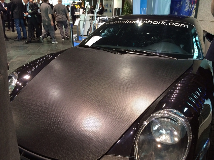

streetshark_1.jpegAt this year's international Plastics in Automotive Engineering 2014 conference hosted by the German Association of Engineers (VDI) in Mannheim, a testosterone-boosting mean-looking number with a matte black Street Shark hood was one of the attractions on display.

Rudholzer: "We wanted to use nature's characteristics for aerodynamics. Together with our development partner Eschmann-Textures, we created a tool with a shark surface texture. We built a positive model from a negative impression taken from a real shark skin, from which we then built a negative tool. We used an In Mold Coating (IMC) process, which enabled production of the finished component straight from the mold."
The first test modules produced in this way were the hood and roof module of a BMW Z4.
Wind tunnel testing showed that the use of the shark skin engine hood reduced the back pressure in front of the windscreen, which in turn also resulted in an improved drag coefficient value.
