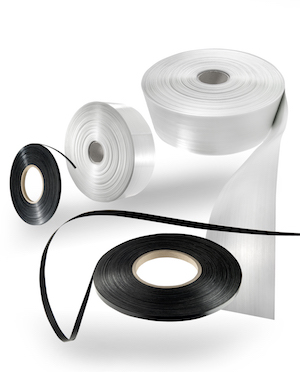

Undirectional tapes based on HDPE and PP resins can be applied in a diverse array of applications headed by automotive and industrial.
SABIC is launching a new UDMAX GPE 45-70 tape, a glass-filled high-density polyethylene composite suitable of applications used in the water distribution and oil and gas sectors. Additionally, SABIC is featuring a large roll sample of UDMAX GPP 45-70 polypropylene (PP) tape, with a 4,000 meter running length, along with a variety of applications using this material, including an automotive bulkhead and an industrial pressure vessel.

SABIC’s UDMAX tapes are unidirectional CFRTCs that reportedly offer exceptionally lightweight and high strength as a replacement solution for metal, plywood and other traditional materials. They feature a proprietary high-pressure fiber impregnation technology (HPFIT) that quickly and precisely enables the spread and combination of thousands of glass or carbon fibers with a thermoplastic matrix. “The result is a resin-rich surface containing a high density of continuous fibers, minimal void content and fewer broken fibers”, added Joris Wismans, technology director, SABIC FRT. UDMAX tapes are available in different slitted sizes in rolls of up to 4,000 running meters.
