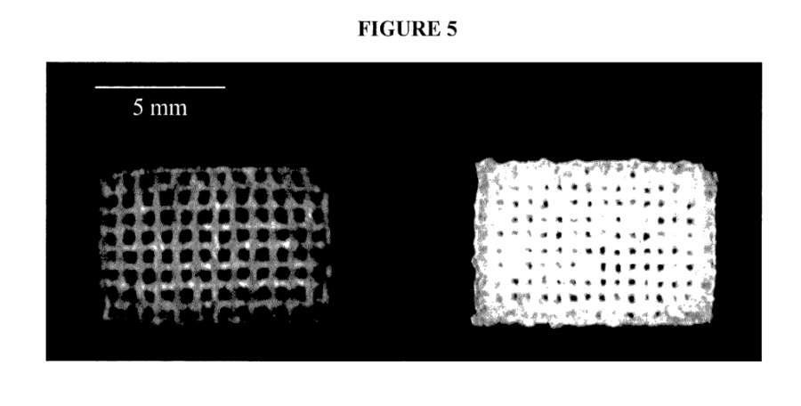

An image shows bone grafts used to fill large volume cavities to repair cranium defects. Dr. Venu Varanasi from the University of Texas and Texas A&M University College of Dentistry led a team that developed a technique to use 3D-printed scaffolds to replace bones in severe cranium injuries in a similar way to how cavities are filled at the dentist. (Source: U.S. patent application US20170143831A1)

In lab tests, researchers fabricated scaffolds into a mesh design with dimensions matching that of formed defects. After four weeks, they extracted cranial bone samples and evaluated them by micro-CT.
Results showed that nearly 55 percent of the bone defect was healed after four weeks for higher Lp- rich-MAG scaffolds versus lower Lp-containing MAG scaffolds, according to the team. In contrast, empty control defects only had 11 percent of the defect filled with bone after four weeks.
