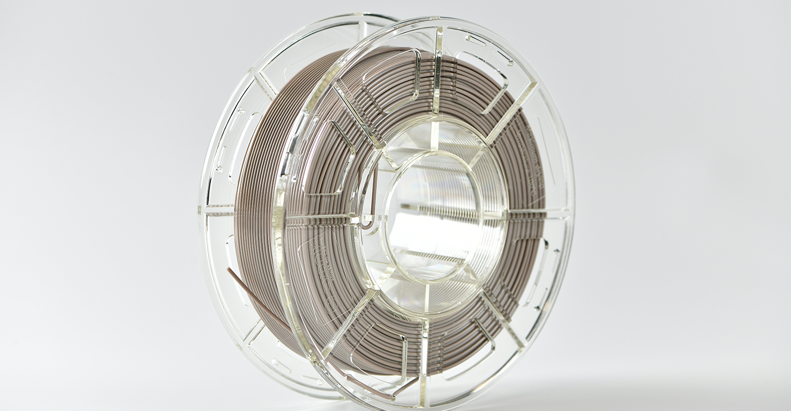

Evonik VESTAKEEP i4 3DF filament on spool
Image courtesy of Evonik
