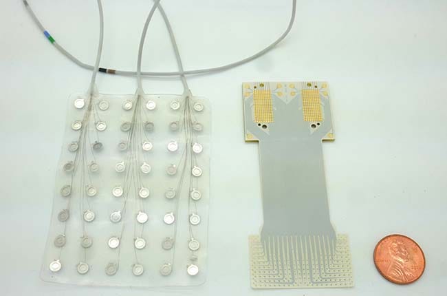

Cogan teamed up with fellow Duke Institute for Brain Sciences faculty member Jonathan Viventi, PhD, whose team packed 256 microscopic brain sensors onto a postage stamp–sized layer of medical-grade liquid crystal polymer thin film.
The device developed by Duke engineers (right) carries twice as many sensors in a smaller footprint than current speech prosthetics with 128 electrodes (left). Image courtesy of Dan Vahaba/Duke University.
