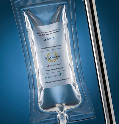

A proprietary radio-frequency (RF) welding technology from Genesis Plastics Welding (Fortville, IN) enables the joining of thin-gauge polyethylene, polypropylene and low-loss polymers without the use of plasticizers or additives. The bolt-on ecoGenesis technology reportedly can allow most existing RF machines to weld polymers with dielectric constants well below the 0.02 level, facilitating manufacturing with an array of materials other than PVC and polyurethane (PU). Medical, automotive, military, packaging and consumer applications stand to benefit, according to Genesis Plastics Welding.

In medical manufacturing, the technology enables the replacement of PVC, which has come under scrutiny in some quarters for health-related issues involving plasticizers. However, there are numerous reasons an OEM may look to replace materials within a product or device, noted Tom Ryder, President and CEO of Genesis Plastics Welding. “In some situations, materials may not be performing to a desired specification, or a client may be looking for different aesthetics or searching for cost savings. Often when PVC is not performing as desired, manufacturers look to PU first, since it is one of the most durable films in medical device manufacturing today, but it comes with a hefty price tag,” Ryder told PlasticsToday. “Our ecoGenesis technology allows OEMs the opportunity to consider lower cost olefin films, said Ryder. “Most recently we’ve worked with large medical device OEMs to replace PU with olefin films in products like ostomy bags, laparoscopic balloons, negative pressure wound care, patient positioning devices, hemostasis devices and medical device coolant bags. The good news for the industry is that multiple companies (PolyOne and Teknor Apex, to name two) have developed films created from blended olefin compounds that are more durable than PVC and perform more similarly to PU materials while costing much less than PU. Several options abound for sourcing,” said Ryder.
