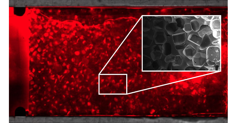

The sponge-like structure of a chip developed by researchers at Karlsruhe Institute of Technology (KIT) that can collected bacteria (shown in gray) was produced with salt crystals. In the lab, it is colonized by the red microorganisms within a few days.Image courtesy of Institute for Biological Interfaces-1, KIT

Researchers did have to tweak the medical version of the silicone so it could be habitable for microorganisms, however. They added table salt to the polymer, which was dissolved again afterwards but formed small holes connected by small passageways. This is what gave the material the sponge-like structure researchers were seeking, they said.
When it takes a porous structure, "the material can take up microorganisms from the environment, no matter how moist or dry it is," Niemeyer explained in a press statement.
They then embedded the sponge in a chip composed of the same silicone as the sponge, except in its homogeneous form, they said.
