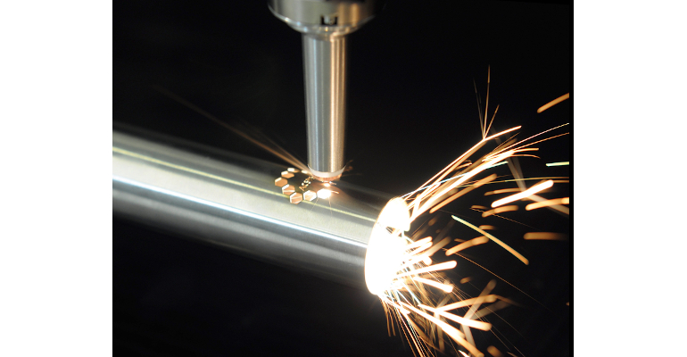

High-precision laser cutting of tubes.Image courtesy ACSYS Lasertechnik UK Ltd.
