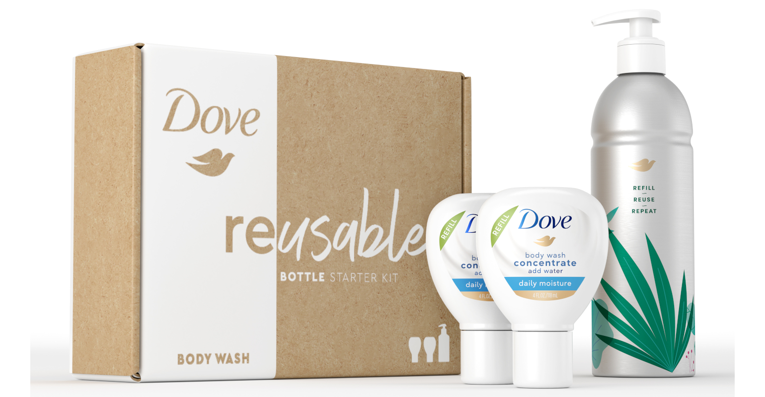

Sustainability is the watchword for a new product line from Unilever called Dove Body Wash Reusable Bottles + Concentrate Refills. The packaging design targets plastic waste with a buy once/refill many times concept.
The product’s starter kit comprises a reusable pump bottle made of either aluminum or high-density polyethylene (HDPE), plus one 4-oz HDPE refill bottle containing body wash concentrate. The HDPE in both cases is recyclable. After their initial purchase, consumers only buy the small refills.
To whip up a batch of body wash, consumers simply screw the refill’s mess-free “quick-connect cap” onto the larger bottle. Continued twisting produces a loud “click,” the cue to squeeze the contents of the refill into the reusable bottle.
Next, users add water to the larger bottle, replace and relock the pump, and shake to mix the water and concentrate. The pump locks and unlocks with a simple twist, but without a change in elevation, the way some other pumps work. According to Unilever, the pump height is not an aid for proper product dosing.

Secondary packaging for the brick-and-mortar retail starter kit is a micro-flute corrugated display pack with die cuts, flaps, and a corrugated insert to hold the reusable bottle and refill in place; a dot of adhesive provides extra security for keeping the refill in place.
One clever feature of the secondary packaging is that the flap around the neck of the reusable bottle, which holds it in place, requires consumers to unscrew and remove the pump before removing the bottle from the display pack. This design leads consumers to take the first step in filling the reusable bottle: Remove the pump closure.
