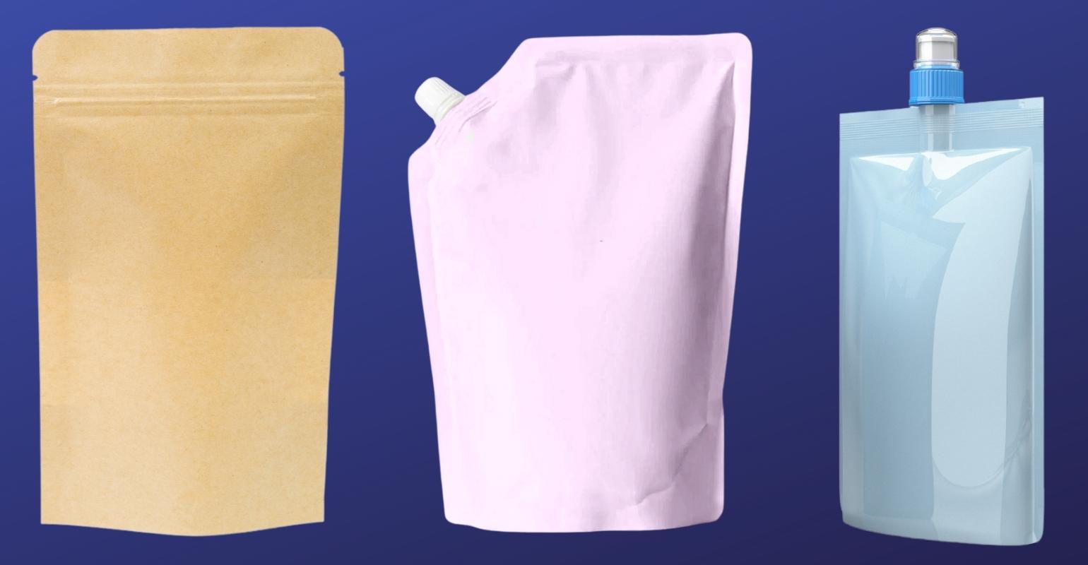

With or without dispensing fitments or zippers, the stand-up pouch is an example of a three-side-sealed pouch created on a horizontal pouch machine.Images courtesy of Canva
The three-sided pouch is a simple and elegant package. It is used for solids or liquids in sizes ranging from a few grams of salt to 10 pounds of chicken. Machines can be intermittent or continuous motion. Speeds can run from a few pouches per minutes to 400 or more.
