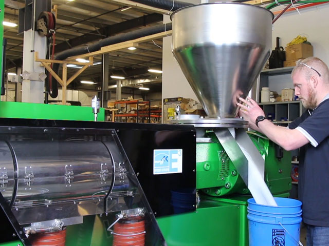

Rotary hopper after having been pivoted to facilitate dumping of excel material

  • Rotary Hopper: This reduces cleanout time to about one minute through its capability of being pivoted away from the feed throat for rapid dumping of excess material for vacuuming residual material and adding purge or new material. In contrast, cleanout of a conventional hopper requires about six minutes because it must be manually emptied of excess material and can be accessed for vacuuming only through its opening from above. Time saved: 5 minutes.
