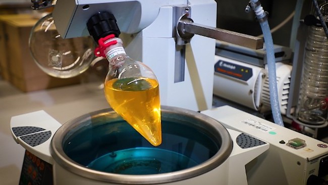

Depolymerization of waste PLA at Fraunhofer ICT uses a conventional and commercialized eco-friendly, organic catalyst. Image courtesy Fraunhofer ICT.

Fraunhofer ICT’s process represents an economically and environmentally sustainable recycling strategy capable of nearly completely depolymerizing the PLA substrate along with a high yield of ethyl lactate (80%) in a relatively short period of time (< 20 minutes) and under mild reaction conditions (< 70o C, ambient pressure). A highly beneficial feature of this system, noted Fraunhofer, is the use of a conventional and commercialized eco-friendly, organic catalyst.
The low-boiling solvent is capable of selectively dissolving the PLA fraction from a mixed plastic waste stream, consisting mainly of PET and PP. This flexible process scheme is capable of handling virgin PLA of different grades as well as post-consumer PLA cups. The process was develpoed in 2019 from a laboratory scale to a technical scale (15 L) and its robustness was demonstrated by recycling post-consumer waste PLA cups, without any effect on the yield of the lactate ester.
“The depolymerization process for PLA developed in my group by PhD students will selectively and in an environmental way dissolve PLA only, thereby leaving PP and PET untouched and PLA-free,” Pico stated.
