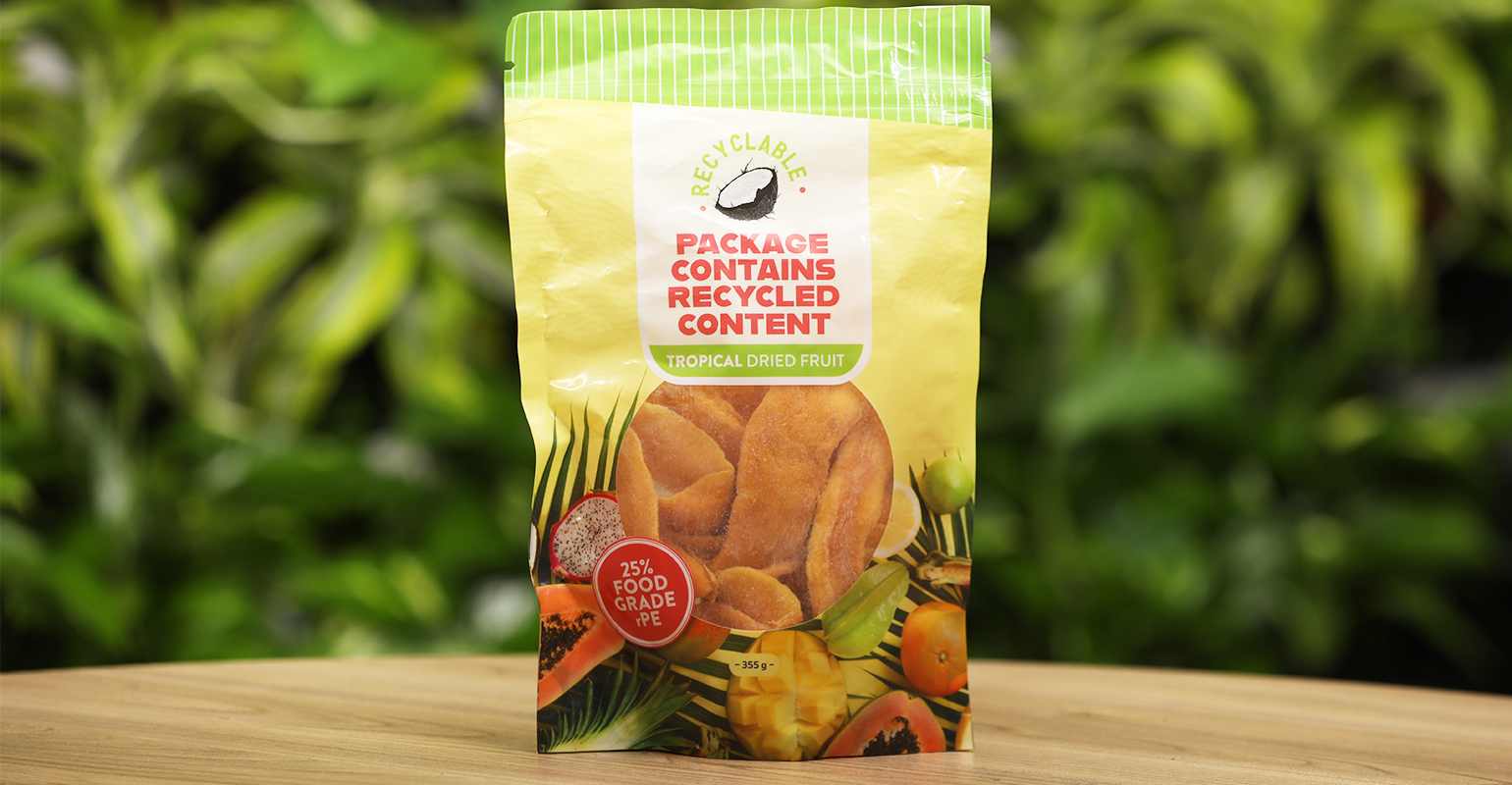

Resin producer Nova Chemicals, Calgary, Alberta, together with packaging supplier Pregis, Chicago, developed flexible food packaging made from recycled polyethylene (rPE).
Flexible pack formats will include stand-up pouches (SUPs), pouches with fitments, and lay-flat bags.
The packaging film is made using Syndigo rPE-0860-FC resin, which is Nova’s first mechanically recycled, food-contact rPE grade. It's sourced from post-consumer high-density polyethylene milk, water, and juice jugs.
The resin is also suitable for rigid food packaging.
The 100% mechanically recycled resin is produced in Canada, and Pregis manufactured film for the flexible rPE packaging at its blown-film extrusion facility in Anderson, SC.
